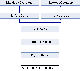

| | SingleRefMakerPatchNode () |
| | ~SingleRefMakerPatchNode () |
| RefResult | NotifyRefChanged (const Interval &changeInt, RefTargetHandle hTarget, PartID &partID, RefMessage message, BOOL propagate) |
| | Receives and responds to messages. More...
| virtual void | GetClassName (MSTR &s) |
| | Retrieves the (localizable) name of the plugin class. More...
| CoreExport | SingleRefMaker (AutoDropRefOnShutdown autoDropRefOnShutdown=Never) |
| | Constructor. More...
| CoreExport | SingleRefMaker (ReferenceTarget *refTarg, AutoDropRefOnShutdown autoDropRefOnShutdown=Never) |
| CoreExport | ~SingleRefMaker () |
| | Destructor. More...
| CoreExport void | SetRef (RefTargetHandle rt) |
| | Set the Reference. More...
| CoreExport RefTargetHandle | GetRef () const |
| | Get the Reference. More...
| CoreExport void | SetAutoDropRefOnShutdown (AutoDropRefOnShutdown autoDropRefOnShutdown) |
| | Set whether/when to auto drop the Reference on shutdown. More...
| CoreExport AutoDropRefOnShutdown | GetAutoDropRefOnShutdown () const |
| | Get whether/when to auto drop the Reference on shutdown. More...
| CoreExport RefResult | NotifyRefChanged (const Interval &changeInt, RefTargetHandle hTarget, PartID &partID, RefMessage message, BOOL propagate) |
| | By default handles REFMSG_TARGET_DELETED message only. More...
| CoreExport void | DeleteThis () |
| | Deletes an instance of this class. More...
| CoreExport SClass_ID | SuperClassID () |
| | Retrieves a constant representing the type of the plugin. More...
| CoreExport int | NumRefs () |
| | Returns the total number of references this ReferenceMaker can hold. More...
| CoreExport RefTargetHandle | GetReference (int i) |
| | Returns the 'i-th' reference. More...
| CoreExport BOOL | CanTransferReference (int i) |
| | Tells whether this reference can be transfered. More...
| CoreExport RefResult | ReplaceReference (int which, RefTargetHandle newtarg, BOOL delOld=TRUE) |
| | Used when cloning reference makers. More...
| CoreExport RefResult | DeleteAllRefsFromMe () |
| | Deletes all references from this ReferenceMaker. More...
| virtual RefResult | DeleteAllRefsToMe () |
| | Deletes all refs to this RefMaker/RefTarget. More...
| CoreExport RefResult | DeleteAllRefs () |
| | Deletes all references both to and from this item. More...
| CoreExport RefResult | DeleteReference (int i) |
| | Deletes the specified reference. More...
| CoreExport ReferenceSaveManager & | GetReferenceSaveManager () |
| | Access the ReferenceSaveManager of this ReferenceMaker. More...
| virtual CoreExport IOResult | Save (ISave *isave) |
| | Called for saving data. More...
| virtual CoreExport IOResult | Load (ILoad *iload) |
| | Called for loading data. More...
| virtual int | RemapRefOnLoad (int iref) |
| | Used to load old files with references. More...
| virtual CoreExport void | RescaleWorldUnits (float f) |
| | Rescale size of all world units in reference hierarchy. More...
| virtual CoreExport void | EnumAuxFiles (AssetEnumCallback &assetEnum, DWORD flags) |
| | Enumerate auxiliary files (e.g. bitmaps) More...
| virtual CoreExport void | SaveEnum (SaveEnumProc &sep, BOOL isNodeCall=0) |
| | The default save enumeration. More...
| virtual CoreExport bool | SpecifySaveReferences (ReferenceSaveManager &referenceSaveManager) |
| | Used to specify reference slot remapping during scene file save. More...
| CoreExport int | DoEnumDependents (DependentEnumProc *dep) |
| | Begins an enumeration that searches back in the dependency network. More...
| virtual CoreExport int | DoEnumDependentsImpl (DependentEnumProc *dep) |
| | Method to perform an enumeration on a ReferenceTarget. More...
| CoreExport bool | EnumRefHierarchy (RefEnumProc &proc, bool includeCustAttribs=true, bool includeIndirectRefs=true, bool includeNonPersistentRefs=true, bool preventDuplicatesViaFlag=true) |
| | This method provides a general purpose reference enumerator. More...
| CoreExport int | FindRef (RefTargetHandle rtarg) |
| | Get the index of the ReferenceTarget. More...
| virtual BOOL | IsRefTarget () |
| | Tells whether it is a ReferenceTarget. More...
| virtual BOOL | IsRefMaker () |
| | Tells whether it is a ReferenceMaker. More...
| virtual BOOL | IsRealDependency (ReferenceTarget *rtarg) |
| | Returns whether this is a "real" (strong) dependency or not. More...
| virtual BOOL | ShouldPersistWeakRef (RefTargetHandle rtarg) |
| | Specifies whether a weak reference is to be persisted on a partial load or save. More...
| virtual CoreExport void * | GetInterface (ULONG id) |
| | Returns a pointer to the interface. More...
| virtual CoreExport BaseInterface * | GetInterface (Interface_ID id) |
| | Returns a pointer to the Base Interface. More...
| CoreExport | ReferenceMaker () |
| CoreExport void | DeleteMe () |
| virtual CoreExport RefResult | NotifyDependents (const Interval &changeInt, PartID partID, RefMessage message, SClass_ID sclass=NOTIFY_ALL, BOOL propagate=TRUE, RefTargetHandle hTarg=NULL, NotifyDependentsOption notifyDependentsOption=REFNOTIFY_ALLOW_OPTIMIZATIONS) |
| | Send a notification all classes that reference this class. More...
| virtual void | FreeCaches () |
| virtual int | NumChildren () |
| virtual Animatable * | ChildAnim (int i) |
| virtual CoreExport MSTR | NodeName () |
| virtual void | EditTrack () |
| virtual CoreExport BOOL | SubAnimSetKeyBufferPresent (int subNum) |
| | returns true if the sub-anim has a "Set Key" buffer present More...
| virtual BOOL | SetKeyBufferPresent () |
| | returns true if there is a "Set Key" buffer present More...
| virtual CoreExport void | SubAnimCommitSetKeyBuffer (TimeValue t, int subNum) |
| | Commit any "Set Key" buffers on the given sub-anim. More...
| virtual void | CommitSetKeyBuffer (TimeValue t) |
| | Commit any "Set Key" buffers. More...
| virtual CoreExport void | SubAnimRevertSetKeyBuffer (int subNum) |
| | Revert any "Set Key" buffers on the given sub-anim. More...
| virtual void | RevertSetKeyBuffer () |
| | Revert any "Set Key" buffers. More...
| virtual LRESULT CALLBACK | TrackViewWinProc (HWND hwnd, UINT message, WPARAM wParam, LPARAM lParam) |
| | This function is obsolete. More...
| virtual bool | IsParamBlockDesc2Used (ParamBlockDesc2 *desc) |
| | Returns true if the passed description is being used. More...
| virtual bool | GetMacroRecorderName (bool used_as_rhs_value, MSTR &objectSpecifiedName) |
| | This method is called to access the object specified name to use for the Maxscript macrorecorder. More...
| CoreExport | Animatable () |
| MSTR | ClassName () const |
| | Returns the name of the plugin class. More...
| virtual CoreExport Class_ID | ClassID () |
| | Retrieves a constant that uniquely identifies the plugin class. More...
| virtual void | BeginEditParams (IObjParam *ip, ULONG flags, Animatable *prev=NULL) |
| virtual void | EndEditParams (IObjParam *ip, ULONG flags, Animatable *next=NULL) |
| virtual CoreExport void | ReleaseInterface (ULONG id, void *i) |
| virtual CoreExport int | SetProperty (ULONG id, void *data) |
| virtual CoreExport void * | GetProperty (ULONG id) |
| CoreExport void | AppendProperty (AnimProperty *prop) |
| | A function to directly add arbitrary properties to this object developers should ensure that the properties ID does not conflict with any Max-specific IDs. More...
| CoreExport AnimProperty * | FindProperty (DWORD id) |
| | Find any property. More...
| CoreExport void | AddAppDataChunk (const Class_ID &cid, SClass_ID sid, DWORD sbid, DWORD len, void *data) |
| | Adds application/plugin specific (custom) data to an Animatable. More...
| CoreExport AppDataChunk * | GetAppDataChunk (const Class_ID &cid, SClass_ID sid, DWORD sbid) |
| | Retrieves the application/plugin specific (custom) data stored with an Animatable. More...
| CoreExport BOOL | RemoveAppDataChunk (const Class_ID &cid, SClass_ID sid, DWORD sbid) |
| | Deletes the application/plugin specific (custom) data stored with an Animatable. More...
| CoreExport void | ClearAllAppData () |
| | Deletes all application/plugin specific (custom) data stored with an Animatable. More...
| virtual int | NumSubs () |
| virtual Animatable * | SubAnim (int i) |
| virtual CoreExport MSTR | SubAnimName (int i) |
| virtual BOOL | CanDeleteSubAnim (int i) |
| virtual void | DeleteSubAnim (int i) |
| virtual DWORD | GetSubAnimCurveColor (int subNum) |
| virtual int | SubNumToRefNum (int subNum) |
| virtual BOOL | CanCopyAnim () |
| CoreExport int | HasSubElements (int type=0) |
| virtual int | GetSubFCurveExtents (int subNum, ParamDimensionBase *dim, float &min, float &max, DWORD flags) |
| | The values max and min should be initialized before calling this function. More...
| virtual ParamDimension * | GetParamDimension (int i) |
| virtual BOOL | SelectSubAnim (int subNum) |
| virtual BOOL | BypassTreeView () |
| virtual BOOL | BypassTrackBar () |
| virtual BOOL | BypassPropertyLevel () |
| virtual BOOL | InvisibleProperty () |
| virtual int | NumKeys () |
| virtual TimeValue | GetKeyTime (int index) |
| virtual int | GetKeyIndex (TimeValue t) |
| virtual BOOL | GetNextKeyTime (TimeValue t, DWORD flags, TimeValue &nt) |
| virtual void | CopyKeysFromTime (TimeValue src, TimeValue dst, DWORD flags) |
| virtual void | DeleteKeyAtTime (TimeValue t) |
| virtual BOOL | IsKeyAtTime (TimeValue t, DWORD flags) |
| virtual int | GetKeyTimes (Tab< TimeValue > ×, Interval range, DWORD flags) |
| virtual int | GetKeySelState (BitArray &sel, Interval range, DWORD flags) |
| CoreExport void | OpenTreeEntry (int type, DWORD tv) |
| CoreExport void | CloseTreeEntry (int type, DWORD tv) |
| CoreExport int | IsTreeEntryOpen (int type, DWORD tv) |
| CoreExport BOOL | GetSelInTrackView (DWORD tv) |
| CoreExport void | SetSelInTrackView (DWORD tv, BOOL sel) |
| CoreExport BOOL | InTrackViewSelSet (int which) |
| CoreExport void | SetTrackViewSelSet (int which, BOOL inOut) |
| virtual BOOL | AssignController (Animatable *control, int subAnim) |
| virtual BOOL | CanAssignController (int subAnim) |
| | Return true if we can reassign the subanim specified. More...
| virtual BOOL | CanMakeUnique () |
| CoreExport int | EnumAnimTree (AnimEnum *animEnum, Animatable *client, int subNum) |
| virtual int | RenderBegin (TimeValue t, ULONG flags=0) |
| virtual int | RenderEnd (TimeValue t) |
| virtual CoreExport Interval | GetTimeRange (DWORD flags) |
| virtual void | EditTimeRange (Interval range, DWORD flags) |
| virtual void | DeleteTime (Interval iv, DWORD flags) |
| virtual void | ReverseTime (Interval iv, DWORD flags) |
| virtual void | ScaleTime (Interval iv, float s) |
| virtual void | InsertTime (TimeValue ins, TimeValue amount) |
| virtual BOOL | SupportTimeOperations () |
| virtual CoreExport void | MapKeys (TimeMap *map, DWORD flags) |
| virtual void | DeleteKeys (DWORD flags) |
| virtual void | DeleteKeyByIndex (int index) |
| virtual void | SelectKeys (TrackHitTab &sel, DWORD flags) |
