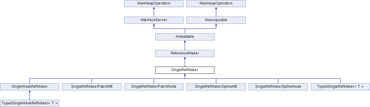

+ Inheritance diagram for SingleRefMaker:
