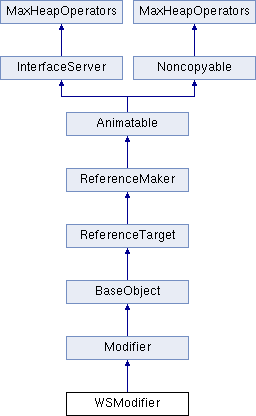

This is a base class for creating world space modifiers.
It simply provides a default implementation of SuperClassID(). World Space Modifier plug-ins use a Super Class ID of WSM_CLASS_ID.
Inheritance diagram for WSModifier:Public Member Functions | |
