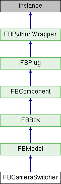

Camera switcher.
This class is a wrapper around the system's camera switcher object. There can only be one switcher in a given scene. Any attempts at creating a new instance will return the existing one.
Inheritance diagram for FBCameraSwitcher:Public Member Functions | |
| __reduce__ () | |
| __init__ (object arg1) | |
| Constructor. More... | |
| UseEvaluateSwitch (FBCameraSwitcher arg1) | |
| bool | PlotToCamera (FBCameraSwitcher arg1, FBCamera arg2) |
| Plot the Camera Switcher animation onto a destination camera. More... | |
