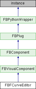

FCurve editor.
Inheritance diagram for FBFCurveEditor:Public Member Functions | |
