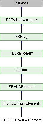

HUD Timeline element. Displays a timeline that shows Head, Cut, Tail regions, and current time cursor. The drawing is defined in the flash file(timeline.swf).
Inheritance diagram for FBHUDTimelineElement:Public Member Functions | |
