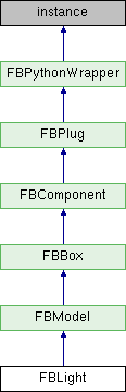

Light class.
Inheritance diagram for FBLight:Public Member Functions | |
