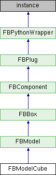

Cube model class.
Inheritance diagram for FBModelCube:Public Member Functions | |
