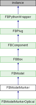

Model marker class.
Inheritance diagram for FBModelMarker:Public Member Functions | |
