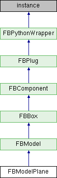

#include <mobu-python-api.h>
Plane model class.
Inheritance diagram for FBModelPlane:Public Member Functions | |
| __reduce__ () | |
| __init__ (object arg1, str arg2) | |

| __init__ | ( | object | arg1, |
| str | arg2 | ||
Constructor.
Python Docstring:
__init__( (object)arg1, (str)arg2) -> None
C++ Signature:
FBModelPlane(const char * pName, HIObject pObject = ((void *) 0))
| pName | Name of Plane. |
| pObject | For internal use only(default=NULL). |
| __reduce__ | ( | ) |
