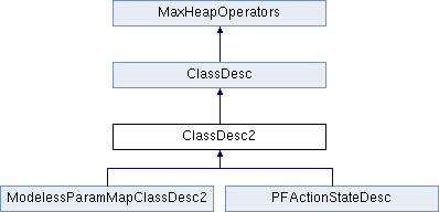

A subclass of ClassDesc which you specialize to provide a class descriptor for plug-in classes that will use the ParamBlock2 system. It contains a table of ParamBlockDesc2s for all the parameter blocks used in the plug-in and a number of sets of methods including access to the block descriptors, auto user interface management, auto param block2 construction, and access to any automatically-maintained ParamMap2s.
+ Inheritance diagram for ClassDesc2:
