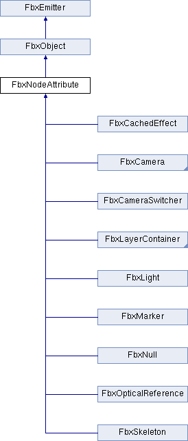

FbxNodeAttribute Class Reference
This class is the base class to all types of node attributes. More...

+ Inheritance diagram for FbxNodeAttribute:

Detailed Description
A node attribute is the content of a node. A NULL node attribute is set by calling function FbxNode::SetNodeAttribute() with a NULL pointer.
Examples:
ImportScene/DisplayAnimation.cxx, MyOwnWriterReader/MyOwnReader.cxx, ViewScene/DrawScene.cxx, and ViewScene/SceneContext.cxx.
Definition at line 29 of file fbxnodeattribute.h.

enum EType
Node attribute types.

int GetNodeCount ( ) const
Return the node count using this attribute.
Returns
The count of nodes with this attribute set.
Examples:
Instances/main.cxx.
FbxNode* GetNode ( int  pIndex = 0) const
Return the node this attribute is set to.
Parameters
pIndexThe index of the node to retrieve
Returns
Pointer to the node, or NULL if the current attribute is not set to a node.
Examples:
ExportScene03/main.cxx, ImportScene/DisplayMaterial.cxx, ImportScene/DisplayMesh.cxx, ImportScene/DisplayTexture.cxx, ViewScene/DrawScene.cxx, ViewScene/SceneCache.cxx, and ViewScene/SetCamera.cxx.
