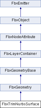

+ Inheritance diagram for FbxTrimNurbsSurface:
