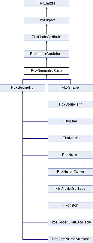

FBX C++ API Reference
FbxGeometryBase Class Reference
This class is the base class for geometric object such as meshes, NURBS and patches. More...
#include <fbxgeometrybase.h>
+ Inheritance diagram for FbxGeometryBase:
