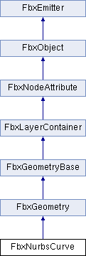

FBX C++ API Reference
FbxNurbsCurve Class Reference
A Non-Uniform Rational B-Spline (NURBS) curve is a type of parametric geometry. More...
#include <fbxnurbscurve.h>
+ Inheritance diagram for FbxNurbsCurve:
