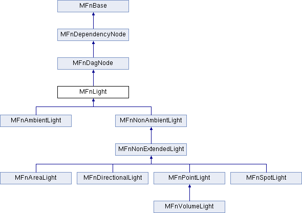

C++ API Reference
Manage dependency graph nodes representing lights. More...
#include <MFnLight.h>
+ Inheritance diagram for MFnLight:

Reimplemented from MFnDagNode.
Reimplemented in MFnSpotLight, MFnNonAmbientLight, MFnNonExtendedLight, MFnAmbientLight, MFnAreaLight, MFnDirectionalLight, MFnPointLight, and MFnVolumeLight.
