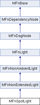

#include <MFnSpotLight.h>
+ Inheritance diagram for MFnSpotLight:
