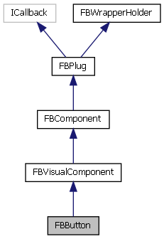

Used to create and manage buttons in a user interface. More...
#include <fbcontrols.h>

Public Member Functions inherited from FBVisualComponent | |

Public Member Functions inherited from FBComponent | |

Public Member Functions inherited from FBWrapperHolder | |
