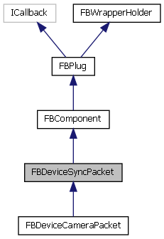

Sync'ed device packet. More...
#include <fbtracker.h>
Public Member Functions | |
| FBDeviceSyncPacket () | |
| Constructor. More... | |

Public Attributes | |
| FBPropertyInt | OriginalSync |
| Property: Sync count for packet (from Application). More... | |
| FBPropertyInt | CorrectedSync |
| Property: Corrected sync count (from Sync queue). More... | |
| FBPropertyInt | DeviceSync |
| Property: Sync count for packet (from Device). More... | |
Data packet base class for packets that correspond to a device that is timestamping the data in order to genlock the application to an incoming data stream.
Definition at line 70 of file fbtracker.h.
Constructor.
| FBPropertyInt CorrectedSync |
Definition at line 78 of file fbtracker.h.
| FBPropertyInt DeviceSync |
