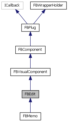

Text edit box. More...
#include <fbcontrols.h>
Public Member Functions | |
| FBEdit (HIObject pObject=NULL) | |
| Constructor. More... | |

Text edit box.
Definition at line 1224 of file fbcontrols.h.
| FBEdit | ( | HIObject | pObject = NULL | ) |
Constructor.
| FBPropertyEvent OnChange |
Event: Text changed.
Definition at line 1233 of file fbcontrols.h.
| FBPropertyEvent OnTransaction |
Event: Transaction begin/end (continuous value changes). This event property doesn't exist in pyfbsdk.
Definition at line 1234 of file fbcontrols.h.
| FBPropertyBool PasswordMode |
Read Write Property: Set password mode for this edit box.
Definition at line 1231 of file fbcontrols.h.
| FBPropertyString Text |
Read Write Property: Text displayed.
Definition at line 1230 of file fbcontrols.h.
