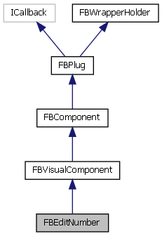

Number edit box. More...
#include <fbcontrols.h>
Public Member Functions | |
| FBEditNumber () | |
| Constructor. More... | |
Public Member Functions inherited from FBVisualComponent | |
| FBVisualComponent (HIObject pObject) | |

Public Member Functions inherited from FBComponent | |
| FBComponent (HIObject pObject) | |

Public Member Functions inherited from FBWrapperHolder | |
