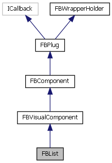

List of items.
Definition at line 1322 of file fbcontrols.h.
