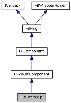

Plot Popup (for setting options only). More...
#include <fbcontrols.h>
Public Member Functions | |
| FBPlotPopup () | |
| Constructor. More... | |
| virtual bool | Popup (const char *pWindowName) |
| Execute plot popup. More... | |
| FBPlotOptions | GetPlotOptions () |
| Get plot options. More... | |
| void | SetPlotOptions (const FBPlotOptions &pPlotOptions) |
| Set plot options. More... | |
Definition at line 2616 of file fbcontrols.h.
| FBPlotPopup | ( | ) |
Constructor.
| FBPlotOptions GetPlotOptions | ( | ) |
Get plot options.
virtual |
Execute plot popup.
| void SetPlotOptions | ( | const FBPlotOptions & | pPlotOptions | ) |
Set plot options.
| pPlotOptions | Set the plot options that will be used when displaying the plot popup. First use the GetPlotOptions(), change the options and use the SetPlotOptions() to set them before calling the Popup() function. |
| FBPropertyBool EnableEvaluateDeformation |
Read Write Property: Enable Evaluate Deformation option for popup.
Definition at line 2638 of file fbcontrols.h.
| FBPropertyBool EnablePlotAuxEffectors |
Read Write Property: Enable Plot Aux Effectors option for popup.
Definition at line 2637 of file fbcontrols.h.
| FBPropertyBool EnablePlotCharacterExtension |
Read Write Property: Enable Plot Character Extension option for popup.
Definition at line 2635 of file fbcontrols.h.
| FBPropertyBool EnablePlotLockedProperties |
Read Write Property: Enable Plot Locked Properties option for popup.
Definition at line 2636 of file fbcontrols.h.
| FBPropertyBool EnablePlotTranslationOnRootOnly |
Read Write Property: Enable Plot Translation On Root Only option for popup.
Definition at line 2633 of file fbcontrols.h.
| FBPropertyBool EnableSmartPlotControls |
Read Write Property: Enable Smart Plot option for popup.
Definition at line 2634 of file fbcontrols.h.
