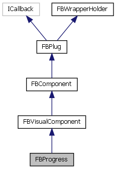

Progress bar. More...
#include <fbcontrols.h>
Public Member Functions | |
| FBProgress () | |
| Constructor. More... | |
| void | ProgressBegin () |
| Start progress, must be called before set Text & Percent property. More... | |
| void | ProgressDone () |
| End progress, must be called to reset progress bar UI to normal status after finishing the task. More... | |
| bool | UserRequestCancell () |
| Return true if User is pressing and holding "ESC" key to request the cancellation. More... | |

Progress bar.
Definition at line 1950 of file fbcontrols.h.
