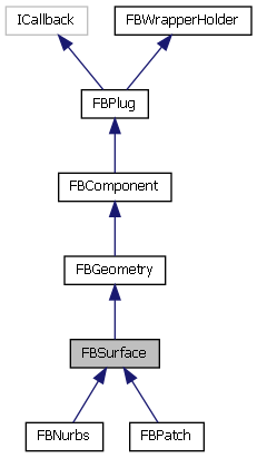

Surface class. More...
#include <fbgeometry.h>

Surface class.
Definition at line 782 of file fbgeometry.h.
