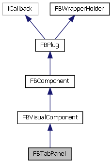

Tab panel. More...
#include <fbcontrols.h>

Tab panel.
Definition at line 989 of file fbcontrols.h.
| FBTabPanel | ( | ) |
Constructor.
| FBPropertyInt ItemIndex |
Read Write Property: Current tab panel.
Definition at line 996 of file fbcontrols.h.
| FBPropertyStringList Items |
List: Names for tab panels.
Definition at line 995 of file fbcontrols.h.
| FBPropertyLayout Layout |
Read Write Property: Layout for current tab panel.
Definition at line 998 of file fbcontrols.h.
| FBPropertyEvent OnChange |
Event: Tab panel change.
Definition at line 999 of file fbcontrols.h.
| FBPropertyInt TabStyle |
Read Write Property: Style of the tab panel, 0 creates normal tabs, 1 creates buttons to activate tabs.
Definition at line 997 of file fbcontrols.h.
