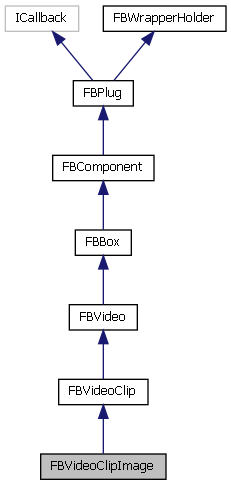

Inheritance diagram for FBVideoClipImage:
