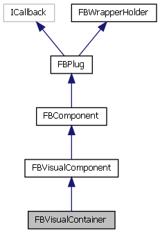

Used to create a container for a tool UI. More...
#include <fbcontrols.h>
Definition at line 1667 of file fbcontrols.h.
