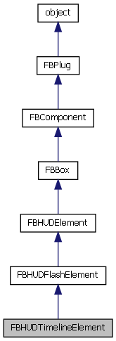

Heads Up display.
HUD Timeline element. Displays a timeline that shows Head, Cut, Tail regions, and current time cursor. The drawing is defined in the flash file(timeline.swf).
See sample: Timeline.py.
| FBHUDTimelineElement | ( | str | pName | ) |
Constructor.
| pName | Name of new HUD flash element. |
