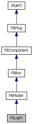

Light class. More...
Public Member Functions | |
| FBLight (str pName) | |
| Constructor. More... | |
