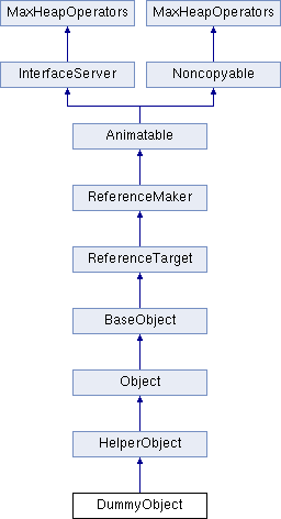

| CoreExport | DummyObject () |
| CoreExport | ~DummyObject () |
| CoreExport Box3 | GetBox () const |
| CoreExport void | SetBox (Box3 &b) |
| CoreExport void | SetColor (Point3 c) |
| CoreExport void | EnableDisplay () |
| CoreExport void | DisableDisplay () |
| CoreExport void | SetValidity (Interval v) |
| CoreExport int | HitTest (TimeValue t, INode *inode, int type, int crossing, int flags, IPoint2 *p, ViewExp *vpt) |
|  | This method is called to determine if the specified screen point intersects the item.  More...
| CoreExport void | Snap (TimeValue t, INode *inode, SnapInfo *snap, IPoint2 *p, ViewExp *vpt) |
|  | Checks the point passed for a snap and updates the SnapInfo structure.  More...
| CoreExport int | Display (TimeValue t, INode *inode, ViewExp *vpt, int flags) |
|  | This is called by the system to have the item display itself (perform a quick render in viewport, using the current TM).  More...
| CoreExport CreateMouseCallBack * | GetCreateMouseCallBack () |
|  | This method allows the system to retrieve a callback object used in creating an object in the 3D viewports.  More...
| CoreExport RefTargetHandle | Clone (RemapDir &remap) |
|  | This method is used by 3ds Max to clone an object.  More...
| Interval | ObjectValidity (TimeValue t) |
|  | This method returns the validity interval of the object as a whole at the specified time.  More...
| CoreExport ObjectState | Eval (TimeValue time) |
|  | This method is called to evaluate the object and return the result as an ObjectState.  More...
| void | InitNodeName (MSTR &s) |
|  | Implemented by the System.  More...
| int | DoOwnSelectHilite () |
|  | If an object wants to draw itself in the 3D viewports in its selected state in some custom manner this method should return nonzero.  More...
| int | IsRenderable () |
|  | Indicates whether the object may be rendered.  More...
| const MCHAR * | GetObjectName () |
| CoreExport void | GetWorldBoundBox (TimeValue t, INode *mat, ViewExp *vpt, Box3 &bbox) |
|  | This method returns the world space bounding box for Objects (see below for the Sub-object gizmo or Modifiers gizmo version).  More...
| CoreExport void | GetLocalBoundBox (TimeValue t, INode *mat, ViewExp *vpt, Box3 &bbox) |
|  | This is the object space bounding box, the box in the object's local coordinates.  More...
| CoreExport void | GetDeformBBox (TimeValue t, Box3 &bbox, Matrix3 *tm, BOOL useSel=FALSE) |
|  | This method computes the bounding box in the objects local coordinates or the optional space defined by tm.  More...
| CoreExport IOResult | Save (ISave *isave) |
|  | Called for saving data.  More...
| CoreExport IOResult | Load (ILoad *iload) |
|  | Called for loading data.  More...
| CoreExport void | RescaleWorldUnits (float f) |
|  | Rescale size of all world units in reference hierarchy.  More...
| CoreExport void | DeleteThis () |
|  | Deletes an instance of this class.  More...
| Class_ID | ClassID () |
|  | Retrieves a constant that uniquely identifies the plugin class.  More...
| void | GetClassName (MSTR &s) |
|  | Retrieves the (localizable) name of the plugin class.  More...
| int | IsKeyable () |
| LRESULT CALLBACK | TrackViewWinProc (HWND hwnd, UINT message, WPARAM wParam, LPARAM lParam) |
|  | This function is obsolete.  More...
| virtual CoreExport bool | PrepareDisplay (const MaxSDK::Graphics::UpdateDisplayContext &prepareDisplayContext) |
| virtual CoreExport bool | UpdatePerNodeItems (const MaxSDK::Graphics::UpdateDisplayContext &updateDisplayContext, MaxSDK::Graphics::UpdateNodeContext &nodeContext, MaxSDK::Graphics::IRenderItemContainer &targetRenderItemContainer) |
| virtual CoreExport unsigned long | GetObjectDisplayRequirement () const |
| SClass_ID | SuperClassID () |
| virtual int | UsesWireColor () |
| virtual BOOL | NormalAlignVector (TimeValue t, Point3 &pt, Point3 &norm) |
|  | Objects that don't support the IntersectRay() method (such as helper objects) can implement this method to provide a default vector for use with the normal align command in 3ds Max.  More...
| CoreExport | Object () |
| CoreExport | ~Object () |
| virtual int | IntersectRay (TimeValue t, Ray &r, float &at, Point3 &norm) |
|  | This method is called to compute the intersection point and surface normal at this intersection point of the ray passed and the object.  More...
| void | LockObject () |
| void | UnlockObject () |
| int | IsObjectLocked () |
| void | LockChannels (ChannelMask channels) |
| void | UnlockChannels (ChannelMask channels) |
| ChannelMask | GetChannelLocks () |
| void | SetChannelLocks (ChannelMask channels) |
| ChannelMask | GetChannelLocks (ChannelMask m) |
| virtual BOOL | CanCacheObject () |
|  | This method determines if this object can have channels cached.  More...
| virtual void | WSStateInvalidate () |
|  | This is called by a node when the node's world space state has become invalid.  More...
| virtual BOOL | IsWorldSpaceObject () |
|  | Returns TRUE if the object as a world space object; otherwise FALSE.  More...
| CoreExport INode * | GetWorldSpaceObjectNode () |
| virtual BOOL | IsParticleSystem () |
| CoreExport void | CopyChannelLocks (Object *obj, ChannelMask needChannels) |
| virtual void | TopologyChanged () |
| virtual int | IsDeformable () |
|  | Indicates whether this object is deformable.  More...
| virtual int | NumPoints () |
|  | The points of a deformable object are accessed through a virtual array interface.  More...
| virtual Point3 | GetPoint (int i) |
| virtual void | SetPoint (int i, const Point3 &p) |
| virtual BOOL | IsPointSelected (int i) |
|  | Returns TRUE if the 'i-th' point is selected; otherwise FALSE.  More...
| virtual float | PointSelection (int i) |
|  | Returns a floating point weighted point selection if the object supports it.  More...
| virtual BOOL | HasWeights () |
|  | Returns TRUE if the object has weights for its points that can be set; otherwise FALSE.  More...
| virtual double | GetWeight (int i) |
|  | Returns the weight of the specified point of the object.  More...
| virtual void | SetWeight (int i, const double w) |
|  | Sets the weight of the specified point.  More...
| virtual BOOL | PolygonCount (TimeValue t, int &numFaces, int &numVerts) |
|  | Retreives the number of faces and vertices of the polyginal mesh representation of this object.  More...
| virtual void | PointsWereChanged () |
|  | Informs the object that its points have been deformed, so it can invalidate its cache.  More...
| virtual CoreExport void | Deform (Deformer *defProc, int useSel=0) |
|  | This is the method used to deform the object with a deformer.  More...
| virtual int | IsMappable () |
|  | This method lets you know if the ApplyUVWMap() method is available for this object.  More...
| virtual int | NumMapChannels () |
|  | Returns the maximum number of channels supported by this type of object.  More...
| virtual int | NumMapsUsed () |
|  | Returns the number of maps currently used by this object.  More...
| virtual void | ApplyUVWMap (int type, float utile, float vtile, float wtile, int uflip, int vflip, int wflip, int cap, const Matrix3 &tm, int channel=1) |
|  | This method may be called to map the object with UVW mapping coordinates.  More...
| virtual CoreExport int | CanConvertToType (Class_ID obtype) |
|  | Indicates whether the object can be converted to the specified type.  More...
| virtual CoreExport Object * | ConvertToType (TimeValue t, Class_ID obtype) |
|  | This method converts this object to the type specified and returns a pointer it.  More...
| virtual Class_ID | PreferredCollapseType () |
|  | This method allows objects to specify the class that is the best class to convert to when the user collapses the stack.  More...
| virtual CoreExport void | GetCollapseTypes (Tab< Class_ID > &clist, Tab< MSTR * > &nlist) |
|  | When the user clicks on the Edit Stack button in the modify branch a list of 'Convert To:' types is presented.  More...
| virtual Object * | CollapseObject () |
|  | This method is called on the world space cache object when the stack gets collapsed, that lets the pipeline object decide, if it wants to return a different object than itself.  More...
| virtual DWORD | GetSubselState () |
|  | For objects that have sub selection levels, this method returns the current selection level of the object.  More...
| virtual void | SetSubSelState (DWORD s) |
| CoreExport void | ReadyChannelsForMod (ChannelMask channels) |
| virtual CoreExport Interval | ChannelValidity (TimeValue t, int nchan) |
|  | Retrieve the current validity interval for the nchan channel of the object.  More...
| virtual CoreExport void | SetChannelValidity (int nchan, Interval v) |
|  | Sets the validity interval of the specified channel.  More...
| virtual CoreExport void | InvalidateChannels (ChannelMask channels) |
|  | This method invalidates the intervals for the given channel mask.  More...
| virtual Object * | MakeShallowCopy (ChannelMask channels) |
|  | This method must make a copy of its "shell" and then shallow copy (see below) only the specified channels.  More...
| virtual CoreExport void | ShallowCopy (Object *fromOb, ChannelMask channels) |
|  | This method copies the specified channels from the fromOb to this and copies the validity intervals.  More...
| virtual CoreExport void | FreeChannels (ChannelMask channels) |
|  | This method deletes the memory associated with the specified channels and set the intervals associated with the channels to invalid (empty).  More...
| virtual CoreExport void | NewAndCopyChannels (ChannelMask channels) |
|  | This method replaces the locked channels with newly allocated copies.  More...
| virtual CoreExport void | MaybeEnlargeViewportRect (GraphicsWindow *gw, Rect &rect) |
|  | This method allows the object to enlarge its viewport rectangle, if it wants to.  More...
| CoreExport bool | IsBaseClassOwnedChannel (int nchan) |
| CoreExport void | UpdateValidity (int nchan, Interval v) |
|  | When a modifier is applied to an object, it needs to include its own validity interval in the interval of the object.  More...
| Interval | GetNoEvalInterval () |
| void | SetNoEvalInterval (Interval iv) |
| virtual CoreExport void | ReduceCaches (TimeValue t) |
|  | This method give the object the chance to reduce its caches.  More...
| virtual int | IsConstObject () |
|  | This is called to determine if this is a construction object or not.  More...
| virtual int | NumPipeBranches (bool selected=true) |
|  | This method returns the number of pipeline branches combined by the object.  More...
| virtual Object * | GetPipeBranch (int i, bool selected=true) |
|  | Retrieves sub-object branches from an object that supports branching.  More...
| virtual INode * | GetBranchINode (TimeValue t, INode *node, int i, bool selected=true) |
|  | When an object has sub-object branches, it is likely that the sub-objects are transformed relative to the object.  More...
