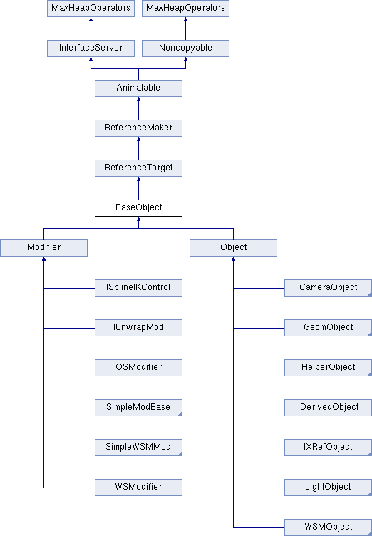

+ Inheritance diagram for BaseObject:

virtual CoreExport ~BaseObject ( )
virtual
Member Function Documentation
virtual CoreExport unsigned long GetObjectDisplayRequirement ( ) const
virtual
virtual CoreExport bool PrepareDisplay ( const MaxSDK::Graphics::UpdateDisplayContext prepareDisplayContext)
virtual
virtual CoreExport bool UpdatePerNodeItems ( const MaxSDK::Graphics::UpdateDisplayContext updateDisplayContext,
MaxSDK::Graphics::UpdateNodeContext nodeContext,
MaxSDK::Graphics::IRenderItemContainer targetRenderItemContainer
virtual
virtual CoreExport bool UpdatePerViewItems ( const MaxSDK::Graphics::UpdateDisplayContext updateDisplayContext,
MaxSDK::Graphics::UpdateViewContext viewContext,
virtual
virtual CoreExport const MaxSDK::Graphics::RenderItemHandleArray& GetRenderItems ( ) const
virtual
virtual CoreExport void* GetInterface ( ULONG  id)
virtual
Inherited from Animatable.
Returns a pointer to the interface.
Parameters
id- The id of the interface.
Returns
A Pointer to the Interface
Reimplemented from ReferenceTarget.
Reimplemented in WSMObject, ShapeObject, LightObject, Object, PatchObject, SimpleParticle, SplineShape, IDerivedObject, TriObject, SimplePolyObject, and SimpleObjectBase.
virtual CoreExport BaseInterface* GetInterface ( Interface_ID  id)
virtual
Returns a pointer to the Base Interface for the interface ID passed.
Parameters
id- The unique ID of the interface to get
Returns
Reimplemented in ShapeObject, LightObject, Object, SimpleManipulator, TriObject, SimplePolyObject, SimpleObjectBase, PFSimpleTest, PFSimpleAction, and PFSimpleOperator.
