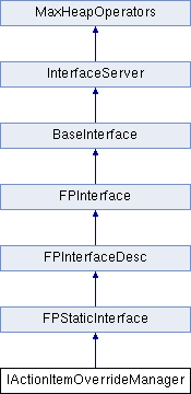

The interface for managing action item overrides.
This manager allows action item overrides to be activated, deactivated and retrieved. This static function-published interface is registered as a core interface. You retrieve this interface by calling
 Note that once an IActionOverrideItem is managed by this interface by activating it, it then will get deleted by this interface.
