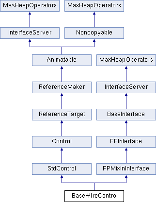

+ Inheritance diagram for IBaseWireControl:
