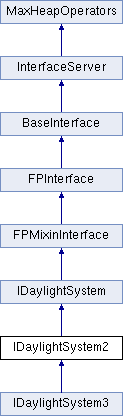

Extends IDaylightSystem with new functionality This interface can be obtained when the daylight system is created.
See IDaylightSystemFactory2::Create In the case of an already existent daylight system, this interface can be obtained from the base object of the daylight assembly:
