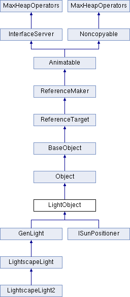

This is the base class from which plug-in lights may be derived.
See also
Class Object, Class ObjLightDesc, Class Interval, Class Texmap.
+ Inheritance diagram for LightObject:
