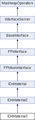

 Inheritance diagram for IDxMaterial3:
 Inheritance diagram for IDxMaterial3:| Public Member Functions | |
