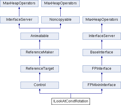

+ Inheritance diagram for ILookAtConstRotation:
