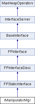

+ Inheritance diagram for IManipulatorMgr:
