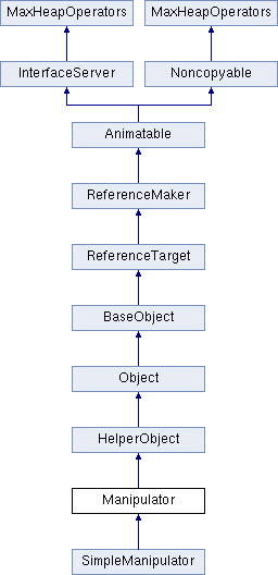

| ManipExport | Manipulator (INode *pINode) |
| BOOL | IsManipulator () |
| virtual int | HitTest (TimeValue t, INode *pNode, int type, int crossing, int flags, IPoint2 *pScreenPoint, ViewExp *pVpt)=0 |
| virtual int | Display (TimeValue t, INode *pNode, ViewExp *pVpt, int flags)=0 |
| virtual void | GetLocalBoundBox (TimeValue t, INode *inode, ViewExp *vp, Box3 &box)=0 |
| virtual ManipExport bool | AlwaysActive () |
| virtual MSTR & | GetManipName ()=0 |
| virtual DisplayState | MouseEntersObject (TimeValue t, ViewExp *pVpt, IPoint2 &m, ManipHitData *pHitData) |
| virtual DisplayState | MouseLeavesObject (TimeValue t, ViewExp *pVpt, IPoint2 &m, ManipHitData *pHitData) |
| virtual void | OnMouseMove (TimeValue t, ViewExp *pVpt, IPoint2 &m, DWORD flags, ManipHitData *pHitData) |
| virtual void | OnButtonDown (TimeValue t, ViewExp *pVpt, IPoint2 &m, DWORD flags, ManipHitData *pHitData) |
| virtual void | OnButtonUp (TimeValue t, ViewExp *pVpt, IPoint2 &m, DWORD flags, ManipHitData *pHitData) |
| virtual INode * | GetINode () |
| virtual ManipExport void | DeleteThis () |
| SClass_ID | SuperClassID () |
