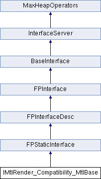

+ Inheritance diagram for IMtlRender_Compatibility_MtlBase:
