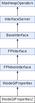

This interace accesses the adaptive subdivision properties.
An instance of this interface can be retrieved using the following line of code (assuming 'node' is of type INode*):
 static_cast<INodeGIProperties2*>(node->GetInterface(NODEGIPROPERTIES2_INTERFACE))
