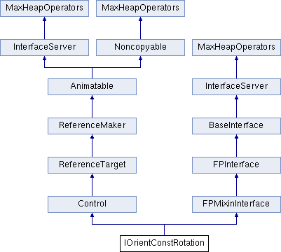

+ Inheritance diagram for IOrientConstRotation:
