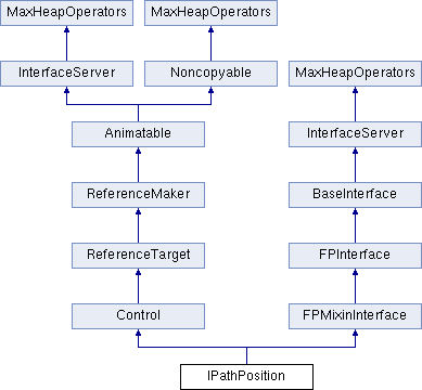

IPathPosition Class Reference
#include <istdplug.h>
Class Description
See also
Class Control, Class INode.
Description:
This class represents the interface to the Path Position Controller. You can obtain a pointer to the path position controller interface using; GetIPathConstInterface(cd). This macro will return
(IPathPosition*)(CD)->GetFPInterface(PATH_CONSTRAINT_INTERFACE).
PATHPOS_PATH_REF may be used to access the position constraint controller's references and PATHPOS_PBLOCK_REF to reference the parameter block.
All methods of this class are Implemented by the System.
+ Inheritance diagram for IPathPosition:

Member Enumeration Documentation
anonymous enum
Enumerator
get_num_targets
get_node
get_target_weight
set_target_weight
append_target
delete_target
Definition: istdplug.h:2265
Definition: istdplug.h:2264
Member Function Documentation
FN_0 ( get_num_targets  ,
TYPE_INT  ,
GetNumTargets
FN_1 ( get_node  ,
TYPE_INODE  ,
GetNode  ,
TYPE_INDEX
FN_2 ( append_target  ,
TYPE_BOOL  ,
AppendTarget  ,
TYPE_INODE  ,
TYPE_FLOAT
FN_1 ( delete_target  ,
TYPE_BOOL  ,
DeleteTarget  ,
TYPE_INDEX
FPInterfaceDesc* GetDesc ( )
virtual
Remarks
Returns a pointer to the class which contains the interface metadata.
Implements FPInterface.
virtual int GetNumTargets ( )
pure virtual
Remarks
This method is available in release 4.0 and later only.
Returns the number of nodes in the path list.
virtual INode* GetNode ( int  targetNumber)
pure virtual
Remarks
Gets one of the path nodes that the path controller follows, specified by targetNumber.
Parameters:
int targetNumber
The node number in the path list to be obtained.
virtual float GetTargetWeight ( int  targetNumber)
pure virtual
Remarks
Gets the weight of one of the path nodes that the path controller follows, specified by targetNumber, and time t. If the targetNumber is not relevant then 0.0f is returned.
Parameters:
int targetNumber
The node number in the path list whose weight is to be obtained.
virtual BOOL SetTargetWeight ( int  targetNumber,
float  weight
pure virtual
Remarks
Sets the weight of one of the path nodes that the path controller follows, specified by targetNumber.
Parameters:
int targetNumber
The node number in the path list whose weight is to be set.
float weight
The weight to assign.
Returns
TRUE if there is more than one path in the list and you are trying to set weight, FALSE otherwise.
virtual BOOL AppendTarget ( INode target,
float  weight = 50.0
pure virtual
Remarks
Appends the current path list by one and appends the current weight list by one.
Parameters:
INode *target
The node that is to be appended to the current path list.
float weight=50.0
The weight to be assigned to the newly appended path.
virtual BOOL DeleteTarget ( int  selection)
pure virtual
Remarks
This method allows you to delete a specified target.
