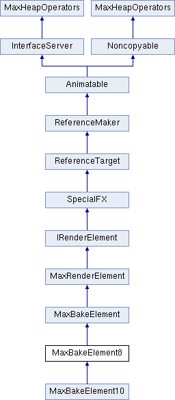

Extention to MaxBakeElement in 3ds Max 8.
Extends MaxBakeElement, allowing Texture Bake Elements to provide parameters of integer, float, and color types in addition to booleans. The RTT dialog is updated to display spinners and color swatches accordingly
 Inheritance diagram for MaxBakeElement8:
 Inheritance diagram for MaxBakeElement8:| Public Types | |
