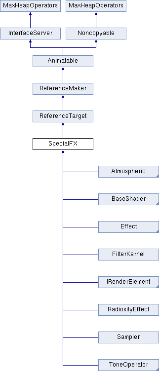

+ Inheritance diagram for SpecialFX:

virtual MSTR GetName ( )
inlinevirtual
Remarks
This method is used to retrieve the name for the plug-in. This name will appear in the track view and the list of current atmospheric or rendering effects.
160 { return _M(""); }
#define _M(x)
Used to wrap string literals.
Definition: strbasic.h:67
virtual BOOL Active ( TimeValue  t)
inlinevirtual
Remarks
Returns TRUE if the effect is active; otherwise FALSE.
Parameters:
TimeValue t
The time at which to check.
Default Implementation:
{ return FALSE; }
Reimplemented in ToneOperator.
169 { return !TestAFlag(A_ATMOS_DISABLED); }
bool TestAFlag(DWORD mask) const
Tests one or more bits in the Animatable flags.
Definition: Animatable.h:281
#define A_ATMOS_DISABLED
The atmosphere effect is disabled.
Definition: AnimatableFlags.h:52
virtual void Update ( TimeValue  t,
Interval valid
inlinevirtual
Remarks
This method is called once per frame when the renderer begins. This gives the atmospheric or rendering effect the chance to cache any values it uses internally so they don't have to be computed on every frame.
Parameters:
TimeValue t
The current time of the call.
Interval& valid
The validity interval of the cache created by the plug-in. The plug-in may set this for its own use. The plug-in can then check if the cache is up to date and update it if not.
182 { }
CoreExport IOResult Save ( ISave isave)
virtual
Remarks
Implemented by the System.
To facilitate naming atmospheric or rendering effects, a 'name' string has been added to the base class. This method should be called from the developers sub-classed Atmospheric or Effects plug-in to save the name.
Reimplemented from ReferenceMaker.
Reimplemented in FilterKernel, Effect, Atmospheric, and BaseShader.
CoreExport IOResult Load ( ILoad iload)
virtual
Remarks
To facilitate naming atmospheric or rendering effects, a 'name' string has been added to the base class. This method should be called from the developers sub-classed Atmospheric or Effects plug-in to load the name.
virtual SFXParamDlg* CreateParamDialog ( IRendParams ip)
inlinevirtual
Remarks
This method creates and returns a new instance of a class derived from SFXParamDlg to manage the user interface. This put up a modal dialog that lets the user edit the plug-ins parameters.
Parameters:
IRendParams *ip
This is the interface given to the plug-in so it may display its parameters.
{ return NULL; }
Reimplemented in FilterKernel, Effect, Atmospheric, IRenderElement, RadiosityEffect, and ToneOperator.
207 { return NULL; }
#define NULL
Definition: autoptr.h:18
virtual BOOL SetDlgThing ( SFXParamDlg dlg)
inlinevirtual
Remarks
Implement this if you are using the ParamMap2 AUTO_UI system and the effect has secondary dialogs that don't have the effect as their 'thing'. Called once for each secondary dialog for you to install the correct thing.
Note: Developers needing more information on this method can see the remarks for MtlBase::CreateParamDlg() which describes a similar example of this method in use (in that case it's for use by a texture map plug-in).
Parameters:
SFXParamDlg* dlg
Points to the ParamDlg.
Returns
Return TRUE if you process the dialog; otherwise FALSE.
{ return FALSE; }
Reimplemented in Effect, Sampler, Atmospheric, IRenderElement, RadiosityEffect, and ToneOperator.
226 { return FALSE; }
virtual int NumGizmos ( )
inlinevirtual
Remarks
If an atmospheric or rendering effect has references to gizmos or other objects in the scene it can optionally provide access to the object list. This method returns the number of gizmos or objects the plug-in has.
{return 0;}
235 { return 0; }
virtual INode* GetGizmo ( int  i)
inlinevirtual
Remarks
Returns a pointer to the 'i-th' gizmo or object node.
Parameters:
int i
The index of the gizmo to return.
{return NULL;}
242 { return NULL; }
#define NULL
virtual void DeleteGizmo ( int  i)
inlinevirtual
Remarks
Deletes the 'i-th' gizmo or object from those used by the plug-in.
Parameters:
int i
The index of the gizmo to delete.
249 { }
virtual void AppendGizmo ( INode node)
inlinevirtual
Remarks
Adds the specified node to the end of the list of gizmos used by the plug-in.
Parameters:
INode *node
Points to the node to append.
257 { }
virtual BOOL OKGizmo ( INode node)
inlinevirtual
Remarks
This method is called to approve a node for possible use as gizmo. Return TRUE if the node is okay; otherwise FALSE.
Parameters:
INode *node
The node to check.
{ return FALSE; }
265 { return FALSE; } // approve a node for possible use as gizmo
virtual void EditGizmo ( INode node)
inlinevirtual
Remarks
This method is called to select the specified gizmo and displays parameters for it (if any).
In the Special Effects section of the light dialog there is a button labelled 'Setup'. The Setup button brings up the Environment dialog (for Atmospherics) or the Render Effects dialog (for Render Effects) and selects the choosen effect. It also selects the "gizmo" within that effect, so if there are particular parameters for each gizmo the user will see them. Pressing that button causes this method to be called.
Parameters:
INode *node
The gizmo node.
279 { } // selects this gizmo & displays params for it if any
virtual void InsertGizmo ( int  i,
INode node
inlinevirtual
Remarks
Inserts the specified gizmo node into the list of gizmos. This method must be defined to use the DeleteGizmoRestore class.
Parameters:
int i
The zero based index of the position in the list of where the insertion should take place.
INode *node
The gizmo node to insert.
{ assert(0); }
290 { assert(0); } // must be defined to use DeleteGizmoRestore
#define assert(expr)
Definition: assert1.h:81
CoreExport SvGraphNodeReference SvTraverseAnimGraph ( IGraphObjectManager gom,
Animatable owner,
int  id,
DWORD  flags
virtual
Remarks
This method is available in release 3.0 and later only.
This method traverses the graph of objects in the 3ds Max scene, adding desired objects to the schematic view. Developers can specialize this behaviour by overriding this method and adding whatever objects are interesting to the schematic view. Objects are added to the schematic view by calling IGraphObjectManager::AddAnimatable(...). Reference lines are added to the schematic view by calling IGraphObjectManager::AddReference(...). Implementers of this method should call it recursively to process other objects in the scene.
See Class IGraphObjectManager.
Parameters
gomPoints to the schematic view window manager.
ownerThe owning animatable.
idThis is usually the sub-anim number (but can actually be any value the developer chooses).
flagsSee Flags for AddAnimatable() and SvTravereseAnimGraph().
Returns
A SvGraphNodeReference object.
Reimplemented from Animatable.
