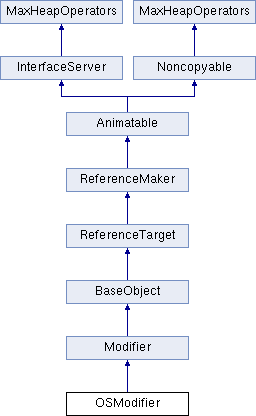

#include <object.h>
This is a base class developers creating object space modifiers may derives their plug-ins from.
It simply provides a default implementation of SuperClassID().
