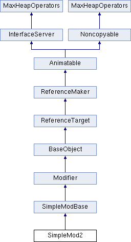

|  | SimpleMod2 () |
| int | NumRefs () override |
|  | Returns the total number of references this ReferenceMaker can hold.  More...
| CoreExport RefTargetHandle | GetReference (int i) override |
|  | Returns the 'i-th' reference.  More...
| int | NumSubs () override |
| CoreExport Animatable * | SubAnim (int subNum) override |
| CoreExport MSTR | SubAnimName (int subNum) override |
| CoreExport int | SubNumToRefNum (int subNum) override |
| CoreExport int | NumParamBlocks () override |
| CoreExport IParamBlock2 * | GetParamBlock (int i) override |
| CoreExport IParamBlock2 * | GetParamBlockByID (BlockID id) override |
| CoreExport void | SimpleMod2Clone (SimpleMod2 *smodSource, RemapDir &remap) |
| CoreExport | SimpleModBase () |
| ChannelMask | ChannelsUsed () override |
|  | These are channels that the modifier needs in order to perform its modification.  More...
| ChannelMask | ChannelsChanged () override |
|  | These are the channels that the modifier actually modifies.  More...
| CoreExport void | ModifyObject (TimeValue t, ModContext &mc, ObjectState *os, INode *node) override |
|  | This is the method that actually modifies the input object.  More...
| Class_ID | InputType () override |
|  | This is the type of object that the modifier knows how to modify.  More...
| CoreExport Interval | LocalValidity (TimeValue t) override |
|  | This method returns the validity interval of a modifier.  More...
| CoreExport Matrix3 | CompMatrix (TimeValue t, ModContext &mc, Matrix3 &ntm, Interval &valid, BOOL needOffset) |
| CoreExport void | CompOffset (TimeValue t, Matrix3 &offset, Matrix3 &invoffset) |
| CoreExport int | HitTest (TimeValue t, INode *inode, int type, int crossing, int flags, IPoint2 *p, ViewExp *vpt, ModContext *mc) override |
|  | This method is used in modifier gizmo hit testing.  More...
| CoreExport int | Display (TimeValue t, INode *inode, ViewExp *vpt, int flagst, ModContext *mc) override |
|  | When this method is called the plug-in should respond by performing a quick render of the modifier gizmo in viewport using the current TM.  More...
| CoreExport void | GetWorldBoundBox (TimeValue t, INode *inode, ViewExp *vpt, Box3 &box, ModContext *mc) override |
|  | This method computes the world space bounding box of the modifier gizmo (or any object that when in sub-object mode has a gizmo).  More...
| CoreExport void | GetSubObjectCenters (SubObjAxisCallback *cb, TimeValue t, INode *node, ModContext *mc) override |
|  | When the user is in a sub-object selection level, the system needs to get the reference coordinate system definition from the current modifier being edited so that it can display the axis.  More...
| CoreExport void | GetSubObjectTMs (SubObjAxisCallback *cb, TimeValue t, INode *node, ModContext *mc) override |
| BOOL | ChangeTopology () override |
|  | This method asks the question of an object or modifier "Do you change
topology"? An object or modifier returns TRUE if it is capable of changing topology when its parameters are being edited; otherwise FALSE.  More...
| CoreExport void | Move (TimeValue t, Matrix3 &partm, Matrix3 &tmAxis, Point3 &val, BOOL localOrigin=FALSE) override |
|  | When this method is called the plug-in should respond by moving its selected sub-object components.  More...
| CoreExport void | Rotate (TimeValue t, Matrix3 &partm, Matrix3 &tmAxis, Quat &val, BOOL localOrigin=FALSE) override |
|  | When this method is called the plug-in should respond by rotating its selected sub-object components.  More...
| CoreExport void | Scale (TimeValue t, Matrix3 &partm, Matrix3 &tmAxis, Point3 &val, BOOL localOrigin=FALSE) override |
|  | When this method is called the plug-in should respond by scaling its selected sub-object components.  More...
| CoreExport BOOL | AssignController (Animatable *control, int subAnim) override |
| CoreExport RefResult | NotifyRefChanged (const Interval &changeInt, RefTargetHandle hTarget, PartID &partID, RefMessage message, BOOL propagate) override |
|  | Receives and responds to messages.  More...
| CreateMouseCallBack * | GetCreateMouseCallBack () override |
|  | This method allows the system to retrieve a callback object used in creating an object in the 3D viewports.  More...
| CoreExport void | ActivateSubobjSel (int level, XFormModes &modes) override |
|  | When the user changes the selection of the sub-object drop down, this method is called to notify the plug-in.  More...
| MAX_DEPRECATED void | SimpleModClone (SimpleModBase *smodSource, RemapDir &remap) |
| CoreExport void | SimpleModBaseClone (SimpleModBase *smodSource, RemapDir &remap) |
|  | When clients are cloning themselves, they should call this method on the clone to copy SimpleModBase's data.  More...
| CoreExport void | BeginEditParams (IObjParam *objParam, ULONG flags, Animatable *prev) override |
|  | Clients of SimpleModBase probably want to override these.  More...
| CoreExport void | EndEditParams (IObjParam *objParam, ULONG flags, Animatable *next) override |
| virtual Deformer & | GetDeformer (TimeValue t, ModContext &mc, Matrix3 &mat, Matrix3 &invmat)=0 |
| virtual void | InvalidateUI () |
| virtual Interval | GetValidity (TimeValue t) |
| virtual BOOL | GetModLimits (TimeValue t, float &zmin, float &zmax, int &axis) |
| CoreExport int | NumSubObjTypes () override |
|  | Objects and modifiers that support subobjects have to overwrite this method - as well as GetSubObjType() - and return a class derived from ISubObjType in GetSubObjType().  More...
| CoreExport ISubObjType * | GetSubObjType (int i) override |
|  | Returns a pointer to the sub-object type for the sub-object whose index is passed.  More...
| CoreExport | Modifier () |
| CoreExport | ~Modifier () |
| SClass_ID | SuperClassID () |
|  | Retrieves a constant representing the type of the plugin.  More...
| MAX_DEPRECATED int | NeedUseSubselButton () |
| virtual void | ForceNotify (Interval &i) |
|  | Notifies dependents of a change.  More...
| CoreExport SvGraphNodeReference | SvTraverseAnimGraph (IGraphObjectManager *gom, Animatable *owner, int id, DWORD flags) |
| CoreExport MSTR | SvGetName (IGraphObjectManager *gom, IGraphNode *gNode, bool isBeingEdited) |
| CoreExport bool | SvCanSetName (IGraphObjectManager *gom, IGraphNode *gNode) |
| CoreExport bool | SvSetName (IGraphObjectManager *gom, IGraphNode *gNode, const MSTR &name) |
| CoreExport bool | SvHandleDoubleClick (IGraphObjectManager *gom, IGraphNode *gNode) |
| CoreExport COLORREF | SvHighlightColor (IGraphObjectManager *gom, IGraphNode *gNode) |
| CoreExport bool | SvIsSelected (IGraphObjectManager *gom, IGraphNode *gNode) |
|  | Returns true if the object is selected in its schematic view.  More...
| CoreExport MultiSelectCallback * | SvGetMultiSelectCallback (IGraphObjectManager *gom, IGraphNode *gNode) |
| CoreExport bool | SvCanSelect (IGraphObjectManager *gom, IGraphNode *gNode) |
| CoreExport bool | SvCanInitiateLink (IGraphObjectManager *gom, IGraphNode *gNode) |
| CoreExport bool | SvCanConcludeLink (IGraphObjectManager *gom, IGraphNode *gNode, IGraphNode *gNodeChild) |
| CoreExport bool | SvLinkChild (IGraphObjectManager *gom, IGraphNode *gNodeThis, IGraphNode *gNodeChild) |
| CoreExport bool | SvCanRemoveThis (IGraphObjectManager *gom, IGraphNode *gNode) |
| CoreExport bool | SvRemoveThis (IGraphObjectManager *gom, IGraphNode *gNode) |
|  | Called when the user deletes this object in the schematic view...  More...
| virtual CoreExport MSTR | GetName () |
|  | Implemented by the System.  More...
| virtual CoreExport void | SetName (MSTR n) |
| void | DisableModApps () |
|  | This method is used internally.  More...
| void | EnableModApps () |
| void | DisableMod () |
| void | EnableMod () |
| int | IsEnabled () |
| void | DisableModInViews () |
| void | EnableModInViews () |
| int | IsEnabledInViews () |
| void | DisableModInRender () |
| void | EnableModInRender () |
| int | IsEnabledInRender () |
| virtual bool | ChangesSelType () |
|  | If a modifier want to make it possible to switch dynamically between changing the selection type that flows up the stack, or leaving it like it is, it can overwrite this.  More...
| CoreExport ChannelMask | TotalChannelsUsed () |
|  | Returns the same value as ChannelsUsed() above except GFX_DATA_CHANNEL will be ORed in if the TOPO_CHANNEL or the TEXMAP_CHANNEL are being used.  More...
| CoreExport ChannelMask | TotalChannelsChanged () |
|  | Returns the same value as ChannelsChanged() above except GFX_DATA_CHANNEL will be ORed in if the TOPO_CHANNEL, the TEXMAP_CHANNEL , or the VERTCOLOR_CHANNEL are being changed.  More...
| virtual void | NotifyInputChanged (const Interval &changeInt, PartID partID, RefMessage message, ModContext *mc) |
|  | This method is called when an item in the modifier stack before this modifier sends a REFMSG_CHANGE message via NotifyDependents().  More...
| virtual BOOL | DependOnTopology (ModContext &mc) |
|  | Modifiers that place a dependency on topology should return TRUE for this method.  More...
| virtual IOResult | SaveLocalData (ISave *isave, LocalModData *ld) |
|  | When a 3ds Max file is being saved, this method is called so that the modifier can save the localData structure that is hung off each ModContext.  More...
| virtual IOResult | LoadLocalData (ILoad *iload, LocalModData **pld) |
|  | When a 3ds Max file is being loaded, this method is called so that the modifier can load the LocalModData structure that is hung off each ModContext.  More...
| CoreExport IOResult | Save (ISave *isave) |
| CoreExport IOResult | Load (ILoad *iload) |
| CoreExport void | EnumModContexts (ModContextEnumProc *proc) |
| CoreExport void | GetIDerivedObject (ModContext *mc, IDerivedObject *&derObj, int &modIndex) |
|  | This method will retrieve the IDerivedObject and index of this modifier for a given modifier context.  More...
| virtual CoreExport void | CopyAdditionalChannels (Object *fromObj, Object *toObj) |
|  | In case the modifier changes the object type (basically the os->obj pointer in ModifyObject) and changes the ExtensionChannel, it has to overwrite this method and copy only the channels that it doesn't modify/added already to the new object.  More...
| CoreExport INode * | GetNodeFromModData (LocalModData *data, int &index) |
|  | This function allows modifiers to find the nodes they are modifying.  More...
| CoreExport INode * | GetNodeFromModContext (ModContext *mc, int &index) |
| virtual CoreExport unsigned long | GetObjectDisplayRequirement () const |
| virtual CoreExport bool | PrepareDisplay (const MaxSDK::Graphics::UpdateDisplayContext &prepareDisplayContext) |
| virtual CoreExport bool | UpdatePerNodeItems (const MaxSDK::Graphics::UpdateDisplayContext &updateDisplayContext, MaxSDK::Graphics::UpdateNodeContext &nodeContext, MaxSDK::Graphics::IRenderItemContainer &targetRenderItemContainer) |
| virtual CoreExport bool | UpdatePerViewItems (const MaxSDK::Graphics::UpdateDisplayContext &updateDisplayContext, MaxSDK::Graphics::UpdateNodeContext &nodeContext, MaxSDK::Graphics::UpdateViewContext &viewContext, MaxSDK::Graphics::IRenderItemContainer &targetRenderItemContainer) |
| virtual CoreExport const MaxSDK::Graphics::RenderItemHandleArray & | GetRenderItems () const |
| virtual CoreExport void * | GetInterface (ULONG id) |
|  | Inherited from Animatable.  More...
| virtual CoreExport BaseInterface * | GetInterface (Interface_ID id) |
| CoreExport | BaseObject () |
| virtual CoreExport | ~BaseObject () |
| virtual BOOL | HasViewDependentBoundingBox () |
|  | This method return true if GetWorldBoundBox returns different boxes for different viewports.  More...
| virtual int | HitTest (TimeValue t, INode *inode, int type, int crossing, int flags, IPoint2 *p, ViewExp *vpt) |
|  | This method is called to determine if the specified screen point intersects the item.  More...
