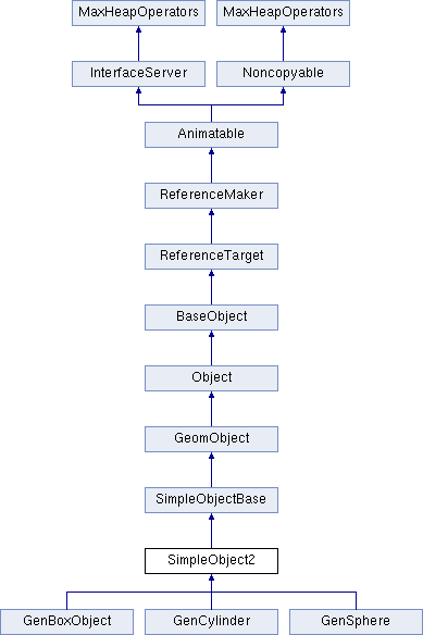

+ Inheritance diagram for SimpleObject2:
