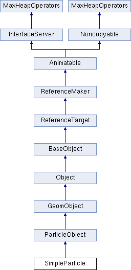

+ Inheritance diagram for SimpleParticle:
